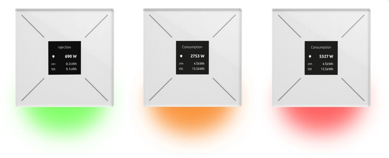

The Velbus energy solution offers an easy-to-understand visualization of your energy situation by showing 3 colors on the Edge lit control panels with or without an OLED screen:
- Green for injection into the electricity grid
- Orange for consumption between 0 and 2.5 kWh
- Red for consumption from more than 2.5 kWh
It is possible to personalize the colors via the free Velbuslink configuration software, so that they are tailored to your unique energy situation.
Furthermore, the control panels display the current energy information on the OLED screen (the current consumption/injection in W), depending on which situation is active at that moment. If additional counters (like solar panel production) are added, they can also be visualized. The control panels contain an internal clock & thermostat, so that you can control heating or cooling systems if you add additional relay modules to control the HVAC system.
The Velbus control panels are installed in central places in your home (for example in the living room, kitchen, office, night hall, etc.), so that you get a clear view of your consumption in the blink of an eye. When switching on or off consumers, you see the color of the panels change instantly, so you know what influence the current situation will have on your bill.
